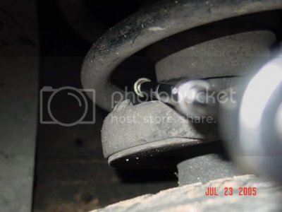

I posted these awhile back.. but i cant find the thread.
If the car is an MTX this will work. As the ATX is ALOT easier to replace. But seeing as you have MTX in your screen name.. :nut:
The back bolt is a PITA!!! no room... so you can do this:
You'll need a few 1/4'' extensions. Or one long one.
If you look closely, you can see the bolt through a hole in theframe
DSC01077
The extended extensions.... :lol:
DSC01073
and there you have it
DSC01072
makes it SOOO much easier. and the install is just as easy. Also, you can get the other bolt out with this method. But you'll need a swivel. The size of the socket is 7/32 or 5.5mm :thumb:
hope that helps!
