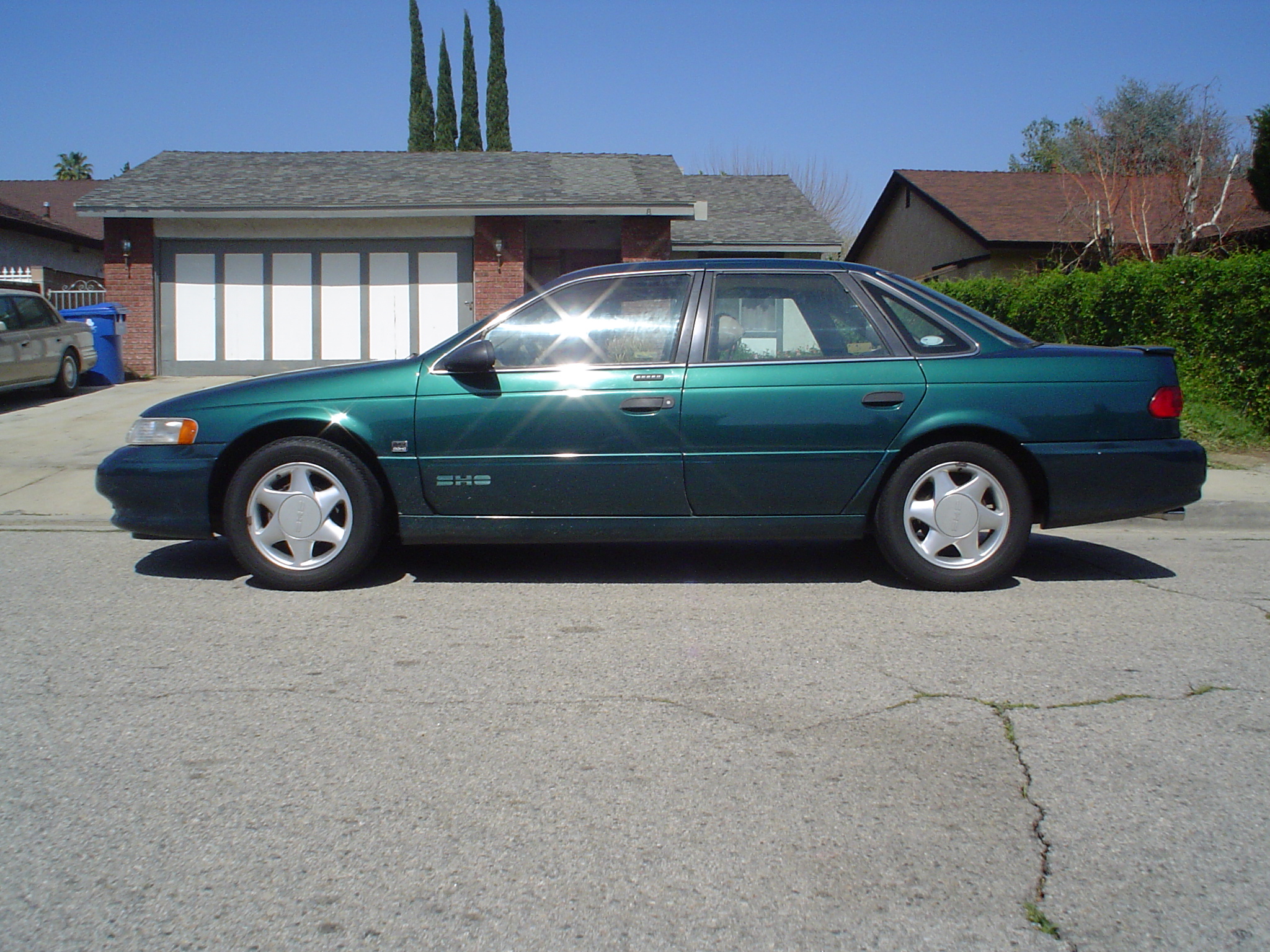

ps...is there anything special about the 93+ slicer wheels that are left and right specific...or no big deal?
I can be wrong but, I think the intend for that is for the slicers to act as some sort of cooling fan for each wheel disc brake, but other than that they should bolt up the same. Of course the direction of the slicers would look backward when running.
