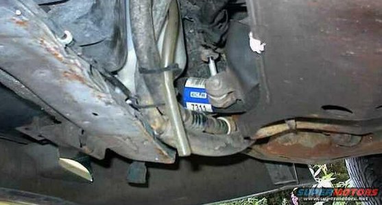

Ok, I'm still confused as to why you don't just walk into NAPA, ask for hose # 7311, and install it??? :shrug: Even with tax, it's under $20 and they should have it on hand. Are there not any NAPA's where you are in FL? Here in Broward they are all over the place.
I've installed probably 30 or 40 of that hose on both MTX and ATX SHO's. It works just fine.
If you search the forum for 7311, I believe Paul N. has some pix of that exact hose installed on his car.
In fact, I'll do the hard work for you, here it is:
Lower rad hose napa 7311 label
