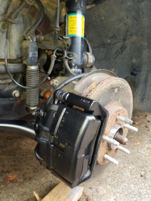

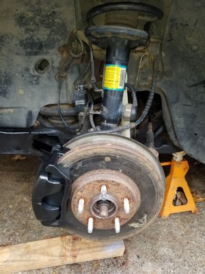

Thanks for all the tips guys. I really appreciate it. We had the drivers side all back together but now we are going to take it all back apart to replace the ball joints. They looked, kinda meh, the passenger sides looked really bad so, I ordered a kit that came with sway bar end links front and rear as well as the ball joints. One of these days I will actually get to drive the car again. Lol.
