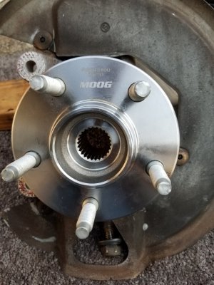

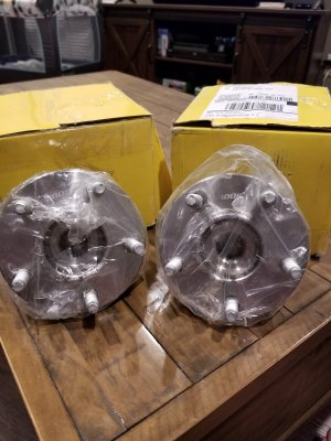

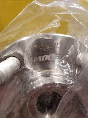

Just arrived today, new Moog front wheel bearings. My son and I will install them next weekend. I've been watching lots of videos about how to do the job but if anyone has any tips, please share, lol. 20221029 11113520221029 111121

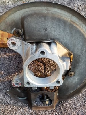

Thanks. So, I found a video showing that once you remove the brake caliper, caliper bracket, rotor and of course the hub nut, you should be able to push the axle back far enough to get to the 3 bolts on the back of the steering knuckle/spindle. Well, that didn't work for me. I could get to the bottom bolts, no problem, but the top one is not accessible due to the ABS ring not allowing to get a socket on the bolt. Also, the strut is down into the steering knuckle/spindle not allowing access to the bolt either. So, we removed the strut bolt on the spindle as well as the brake line retainer bracket and was able to push the strut up to get it out of the way. We disconnected the sway bar end link and the tie rod also. Still cannot push the axle back far enough so we are going to disconnect the lower ball joint and go from there. Hopefully, with all this stuff disconnected we will be able to push the axle back far enough to gain access to the one nut that is holding up this process. The good thing is, there is no rust at all on the parts so, things have been easy, just time consuming and a learning process. I've got to go pick up a "pickle fork" in order to separate the lower ball joint.

Thanks. I went to Harbor Freight and got a big ol honkin pickle fork and was able to remove the ball joint and now the axle is free from the steering knuckle. I ran out of daylight so, we will continue with this project tomorrow when I get home from work. I had loosened up the two bolts that I could get to but dang they are still tight as all get out, my impact wouldn't budge them so I have them soaking in some PB Blaster overnight.

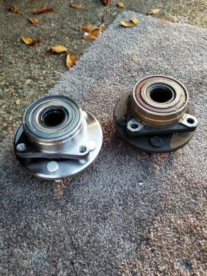

Success. I found the reason my impact would barely move the bolts was because they had blue loctite on them. I was able to break them free with a 1/2 breaker bar and then used the impact the rest of the way. I got the old hub/bearing assembly out with no problems, it slid out without a fight and there was zero corrosion. When I spun the old bearing I could hear the click-clacking of the bearings, the new one is nice and smooth. Going tomorrow to get some brake pads and some blue loctite. 20221108 15490820221108 15475220221108 15462720221108 15454720221108 155131
