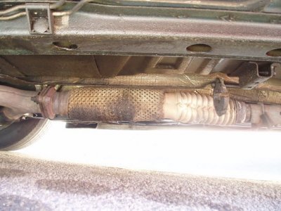

Folks,
Just wanted input from the peanut gallery on my stock 94 atx exhaust situation:
-OE equipment at 141k miles: new york, partially garaged, weekend driving
-symptoms are: large leak in one catalytic converter
-holes in/around the muffler straps/hangers
I'm debating on the most cost effective/quickest repair:

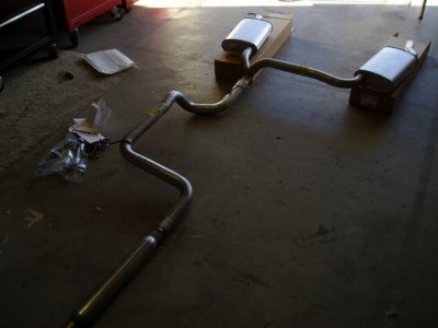

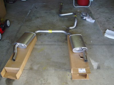

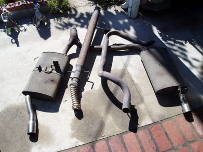

Sorry, I linked to the MTX catback, it's actually this one: http://www.jegs.com/i/Dynomax/289/17399/10002/-1
I have the Dynomax on my '93 ATX, installed it myself. It comes in sections and uses all the stock hanger locations. Clamps together using supplied clamps. You probably need to saw your exhaust off to remove it in sections also.
The photo of the dynomax on shosource is actually the one on my '93. And it's backwards.. :nut:
P1010004
The only thing is it doesn't come with the flex pipe. So if you order the Y pipe and catback you'll still need to get the flex pipe somewhere else. I needed a new cat back and flex when one of the stock clamps caught on a driveway and ripped it apart and smashed it back into the gas tank.

The dynomax kit looks OK and it is OK but it won't last very long and is no performance enhancer, in a few spots (like the rear split) its bad. The mufflers with this kit will last ~2 years at best (in the midwest)!
I bought the SHOSOURCE cat-back kit and like it a lot, I would strongly recomend it. If you can find the Performance Plus designed equal length style its best otherwise just get the catco/magnaflow/carsound stainless cat y-pipe and call it a day.
