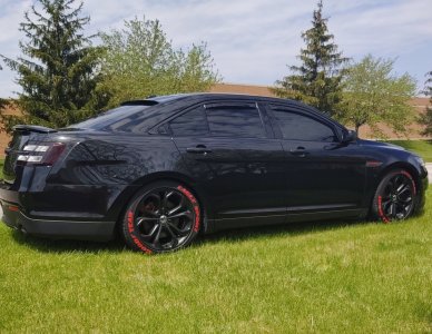

H&R all the way around sets the height nice and turns on a dime.
