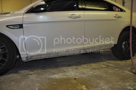

Since I had mine custom painted, the body shop allowed me to watch as they very gingerly had a special tool for removing them from the car. But there were plenty of colorful swear words and other verbiage being shouted out during the process. LOL.

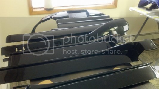

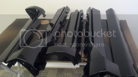

Here's a couple of pics of mine, off the car, and what the car looks like, with them off. I wish now I would've captured shots of the backsides. Ggrrrr.
