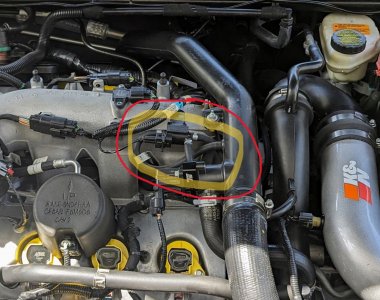

Check the following, and make sure all these vacuum lines are not loose or dry and splitting.

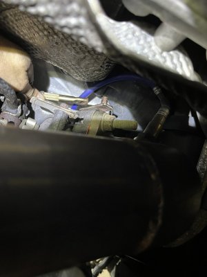

Reviving my thread, the situation has evolved:
Never really figured out the root cause of my issues, didn’t find any major boost leaks or disconnected hoses. Put the stock intake back on and it was a little better to drive, could still tell the issue was there but not as pronounced as it was with the Airraid.
Well, yesterday I finally installed my PPE downpipes and found that the rear turbo wastegate was disconnected from the linkage and was hanging open. Likely the root of a lot of these issues? I reconnected the linkage and took it for a test drive and sadly it drove even worse, threw overboost code for the rear turbo, would not build any boost except for a little down low. I could hear the car hissing loudly when accelerating.
My assumption is that the solenoid or actuator that opens the wastegate isn’t working, and perhaps someone disconnected the linkage on purpose for a cheap fix. Can anyone with more experience tell me if I’m on the right track? I disconnected the linkage and let the wastegate stay open and the car drives like it pretty much always has. I guess I’ll try to pull the rear turbo and replace the actuator but I’m really not excited about doing that with no lift :mad: my neck and back are killing me from doing the downpipes on a concrete floor
Yup, I will wait for others to weigh in - sounds like that turbo needs to come off and address the wastegate actuator that is not working. I admit I have a friend with a lift and it was the only way I was doing the DP's - and I am still sore from a year ago. I hope you checked the plastic charge pipes for splits or cracks. Infamous problem.

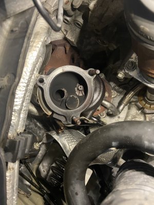

Off subject, did you possibly check the health of the turbine by checking its wiggle? Your car has twice the miles of mine, but that some decent amount of carbon, but I could be making something out of nothing. Did your other turbo have that level of carbon on it?
perhaps the vacuum line on the back of the actuator has popped off i didnt have the time to put the car back up and pull everything off to check it...no leaks or cracks in the plastic piping (will be getting the metal pipe kit soon anyway). both turbines were rock solid and had no wiggle, similiar carbon buildup.
Also, can anyone explain how the wastegates work with a higher boost tune? i have the 3 bar tune kit from gearhead, and i thought wastegates were designed to limit the amount of boost you can make. since these wastegates are analog and pre set to a certain spring tension (i think?), how is the tune and MAP sensor able to make more than factory boost with factory wastegates? maybe you guys are upgrading them and not telling me

OK
the line that goes to the charge piping from the boost solenoid on top of the engine popped off, which i check almost every time i pop the hood :shrug:. reconnected that and the wastegate linkage and the problems went away. no more stuttering, no more overboost. car pulls as good as ever. i still think i have a few minor boost leaks and the car still seems to be making a lot of pressure on the boosted side, perhaps due to the intake and downpipes on a stock tune. BOVs blow off hard if you even tap the throttle and kind of whistle even when your cruising...i did just install the Torque Solutions BOV adapters maybe they are affecting it idk. but the worst of my issues seem to be gone for the time being
