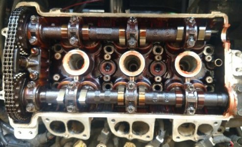

It could be that rust built up on the cylinder walls, destroying compression and allowing oil blow by. I hear what you say about synthetic oil, but I'm a big fan of it because it doesn't leave orange or black deposits all over the place and keeps the internals squeaky clean.
IMG 20180810 120215937 640x389like organic oil.

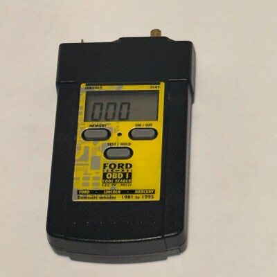

If you didn't disconnect the battery when you charged it, any stored 2 digit codes should still be there:
By all means use a paper clip, but one of these makes it easier:

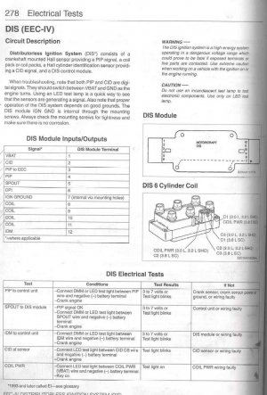

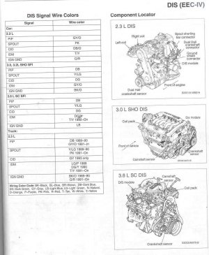

If no codes and no spark, check the DIS:
DIS Test P1DIS Test P2
