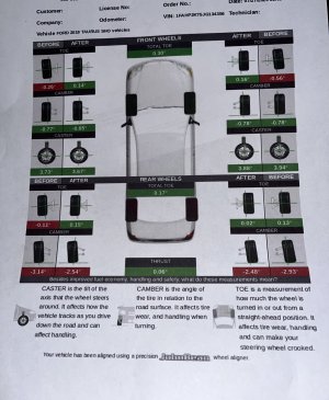

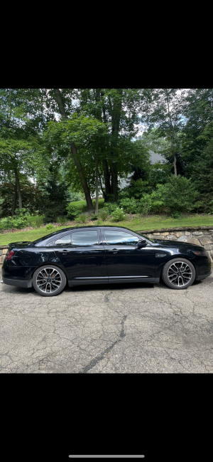

Hi, I recently put on myself some megan racing coilovers and didn’t really measure how much I dropped it but it was enough to level out the car the best I could.
I got an alignment today, they said the rear wheel camber could not get to the recommended specs but was good enough to drive on comfortably.
I will attach a picture of the alignment spec sheet and a picture of the car lowered.
I dont know if not driving it for a couple days changed my view or if im just crazy but without doing any real testing I just feel like ive lost power. Torque from a dig does not feel the same for some reason. Any thoughts or input would be appreciated.
Thanks.

rear camber issues are usually due to shocks. toe links are known issues for certain model years, but idk if they affect camber.
