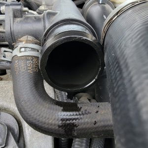

Hello,
I recently switch the tune of my car over to Torrie at Unleashed. I was originally running a LMS 440 package but did not like the transmission performance. I am having issues with the car now after pushing past 11PSI of boost and Torrie has been more than patient with me on trying to work through this and diagnose the problem. The problem is, once we start pushing at all past 11 psi the bypass valve will be commanded open for a split second any time I take the car WOT. This in return will cause the car to stagger and fall on its face through the rest of the run. I have replaced the boost control solenoid and all lines including the addition of clamps, Tried a new 3Bar map sensor, Checked all hot and cold line connections. The only thing I found out of order was some slight oil buildup in the hot pipe coming from the rear turbo but hasn't come back to any significant extent in the last 300 miles. The bypass valve will also open momentarily any time the car shifts down for a 1/2 to 3/4% throttle acceleration from 6th gear. I'm clueless as to what could be commanding this valve to open and I feel I've taken up plenty of Torrie's time troubleshooting an issue I'm sure is on my end.
Some other notes: No noise from Turbos, No noticeable oil consumption, Car feels good in stock form and tuned to 11psi, No DTCs.
Graph Legend: Green= Boost PSI, Pink= Bypass valve, Purple= Waste-gate
Any assistance is greatly appreciated.

Check the connection in the pic attached (clean zip tie bottom center). This was disconnected on my car and I had some weird boost issuses1644882384160

Yup, BOVs are just doing their job. You're spiking >22 psi. Did you verify all wastegate linkage is secure and that both actuators are operating smoothly? I know you replaced the control solenoid and tubing, but is it possible that something is obstructing the pressure source? (ziptied connection in freaksho's picture above)

When I first got it I had issues with that hose coming off. I originally replaced the hose with a piece of 1/4" fuel line and clamped both ends. When the issue persisted I bought the stealership solenoid/hose package and replaced it all along with a couple added factory spring clamps where there weren't any. I can easily blow through the port on the hot pipe going to the solenoid so nothing is in there. The only observation there is there is always an accumulation of oil in/around the ****** even after cleaning. My only assumption based off this is just enough oil is getting pushed into that port to cause a choke point during higher air volumes.
