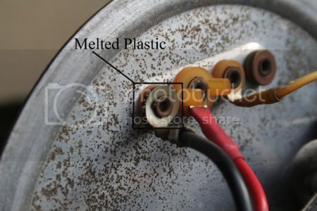

I had a problem kinda similar. Car would die, then be fine. Then it died and never started again. I changed out the CCRM but it still didn't fix it. Fuel pump wasn't running. Then i check the fuel pump housing and find this.
IMG 1754copy
The ground had shorted/melted and it wasn't making contact. I would check out your fuel pump assembly and see if something similar has happened. I just replaced the whole unit and it runs good now.
(Edit)
Also check voltages at the fuel pump, mine was reading good numbers even though it would not run.
