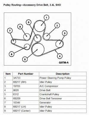

good point on the belt she had to bypass the ac compressor since it locked up and they made her a custom one and i dont think they made it tight enough since it squeals bad when its cold in the winter. so if i can get a belt that is the correct length and that fix it would be great. i hadnt thought about the belt being the issue.

You would need to check out the crank sensor wiring to make sure it would not interfere with the new belt routing.

well its already roughted that way but its not as tight as it should be bc it was a custom made to that length (now why the guy didnt just try to find one in the proper length i dont know). her ac compressor locked up about a year or two ago so they just bypassed it and it squeals when cold and slips above 4k from waht i understand.

ok that means hers has been placed away from the belt. and not to change the subject of the thread, but after we have driven it for a while the idle gets higher then normal, could that just be the tps going bad?
