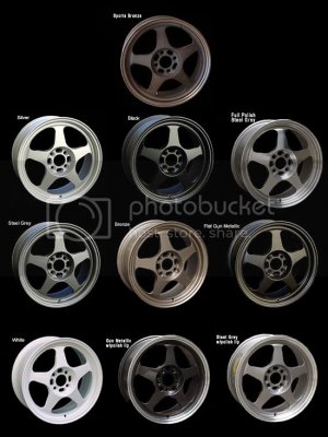

Last call, anyone else want in?
Looks like full polish steel grey is the most desired color.
Slipstreams
Price $585 shipped for set of 4. $200 non-refundable deposit required (payable to the retailer).
