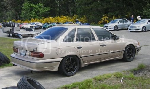

Anyone up for 17x10's w/ 295 tires?? 12mm offset, cut off the rear fenders . . . tires will stick out by about 2" . . .. boy I get goosebumps just thinking about it..:biggrin::biggrin::biggrin:

I am using a 35 mm offset, 7.5" wide 16" wheel and with "wide for their size" 225/55-16 tires, I have needed to trim approximately 8-12 mm from the top and top front portions of the out fender lip on my '91. With the 16"x8" wheels, the 1/2" extra width and 2 mm less outward offset will place the outboard edge of the rim about 0.17" farther outward than my wheels. I suspect without going to the 245 mm section width tire that enough fender can be trimmed to maintain clearance from the tire. The 225 mm section width tires on my 7.5" wide wheels have looked wider than many "wider" tires I have seen mounted on SHOs. With 8" wheels, 225 mm section width tires would look even better and have better sidewall support.
