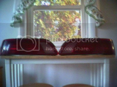

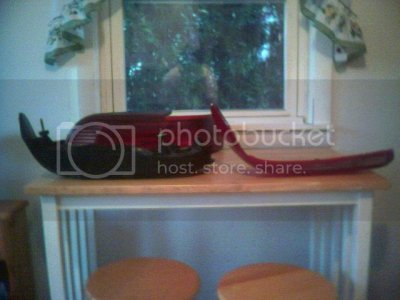

I just began on my LED Taillight Project. I'm using red LED's with clear lenses and I am mounting them on a sheet of plexiglass. I'm still working on the design though I'm not sure how many rows of LED's I should use, how many LED's per row, and if I should use LED's for the reverse lights also. I got 150 LED's along with many resistors. Here are some pics of the beginning of the project I took the red cover off the taillight assemblies so far.

Nice. What do you plan on running the LED's off of? Splice the ~12-14.4V rails back there and daisy chain 4 or 5 on each line? Let us know, looks interesting :thumb:

What method did you use to remove the lenses from the housings? I am ready to start my LED taillight project, but I haven't decided on how to go about removing the lenses. When ManySHOs did his LED tails, he had to use 4 tail lights because he kept cracking the red lenses trying to remove them.

as for arrangement, id opt for following the original lens. 5 horizontal rows of 10-12 LEDS.

I preheated my oven to 400 degrees then i put the assembly in it and checked on it 5 minutes the adhesive began to heat up and I took a little bit of the lens off then put it in and checked on it every 2 minutes. It took about 9 minutes in the oven for it to come off. After that it comes off very easy.
I was thinking about following the original lens with 5 rows like DHMag said and have 3 rows on when my lights are on and when I brake have the other 2 rows light up but I am still debating it.
