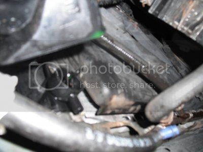

OK found the leak. It's hard to explain but its the very bottom of the radiator (I think) right on the driver side right above subframe. Anyways that weird looking thing is sipping coolant when completely cold and also when I squeeze any of the main radiator hoses. I patched it with JB weld and see if its going to leak tomorrow morning. It's a temporary fix until I bring it to the shop next month.

Is it a crack in the plastic or is it the drain valve that's leaking?
OK I didn't take this picture but one of the member had similar leak on the same side...
DSCF5088
See the drain looking thing? To the right (you can't see in the picture) it connects with the bottom of the radiator and that is where its leaking. Seems to me that the seal is letting go. There is no crack. It just sips through the seal...

Is it right between where the plastic and metal join? If so, that's a very common leak region. You can sometimes also get by by recrimping the metal fingers that attach the two pieces.
If you get a new plastic/metal radiator, you should spend the time going over all the fingers and making sure they are crimped tightly. Or go all aluminum.
Recrimp: http://www.shoforum.com/showpost.php?p=988674&postcount=10
