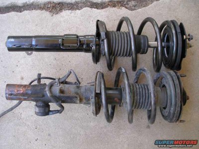

After a couple of months using the Gen 3 Konis setup that SHO Source is selling is just the the right thing for the Eibachs lowering springs. They SARCs in hard mode would still bottom out. They are using the GEN 2 Konis in GEN 3 struts which are a bit shorter.
With the Konis in the softest mode they are comparable to the SARCs and will bottom out under harsh conditions. Bump them up a notch and this goes away. They also sit about a 1/2" lower than the SARCs with Eibachs. The only thing lacking is somewhere to mount the ABS wires and the brake hose.
ABS is easily fixed with the GEN 2 clip on wire holders. The price is competitive to new SARCs which fail with the Eibachs.
Here is a picture of the two side by side. When installed the Knois and new springs are about a 1/2" lower than the SARC and Eibach.

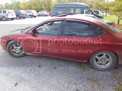

Hey Paul. Do you have any rubbing on hard bumps from your setup? My tires are a bit oversized and rub very slightly on hard compression.
Yea I just got the fronts on because I decided to hold off because I needed to replace an axle and didn't want to do the job twice.

I'm not rubbing on the strut. I'm rubbing on the fender. My tires are 225 but they buldge a bit on the sidewall. When I say oversize I mean the sidewall is taller then stock. It's only a slight rub and I figured it would go away with stock size tires.

Odd as I had no rubbing with my saggy rears with these tires and with the Konis it sits about the same. I had slight rub with my 18s but that could have been taken care of with a fender roller. I'll have to trial fit my 18s and see if that takes care of it.
I can get pics this weekend after I put the new swaybar bushings in.

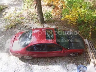

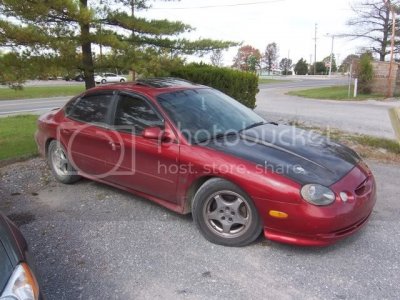

Don't mind the fender. A truck slammed on its brakes and swerved into me make a tight left turn at the last moment.
I know not the best pics, but theyre still pics. It is a bit low, but nothing to be scared of.

Then I should probably say my rubbing issues were due to that accident and a slightly bent down mounting screw for the fender liner.
Edit: Why don't you roll your fenders a bit Paul? You can get the tool and a heat gun from harbor freight for less then $100. There is plenty you can roll in the rear. If it's just rubbing slightly then youre perfectly fine if you roll that lip.
