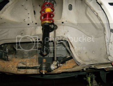

HPIM0444
theres a basic idea, you can see the hole in the bottom and how it sits in the front
for the top you just go down about 1/2 an inch or so and cut a ring around it
