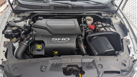

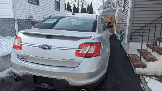

2012 non PP SHO. Delivered yesterday. Purchased online, so a big roll of the dice for me. 86k miles and clean. I'm not a mechanic, but plan to learn how to do what I need to do, to keep it running right. First issue my senses reveal is a noisy front end. It clicks when braking, around stopping and starting, especially when also turning. So, one the first things I want to do is get the front end steering / suspension worked on. Is there a full kit I should be looking at for a front end package? If I'm spending money on repairs, I'm interested in getting the best shit installed. But, I'm not sure what to look for. Please forgive my ignorance. I took a couple pics of the freshly delivered machine.

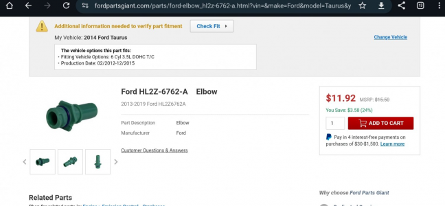

4th - check the system for recall items, replace the PCV valve regardless can't hurt to replace on our year models the part of the PCV system and was re-engineered for models after our years.
