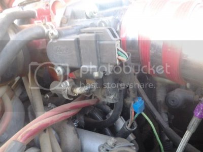

Since we're on the subject I had another question. Just to be sure, what wire is good to tap into for the wiring harness assembly/arming switch? And where can I find the TPS wire to tap into?

Do a search. I posted a step by step a few years ago. I know its still on here. And I posted the zex instructions.
