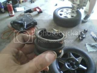

That happened on my Gen III. Put everything back together after installing new valve cover gaskets, only to hear a hissing sound. Took everything apart to find the the coupler split all the way across. New coupler, problem solved.

Haha, I saw only one of mine had a small chunk out of it, we'll see what happens when it runs.
