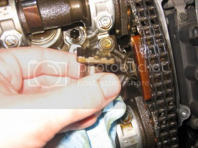

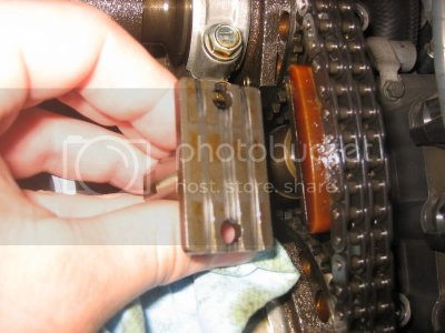

Well, got the motor torn down and a good used tensioner installed (Thanks Eric!)...nice to have things going back together. I had heard rumors that people have not been able to replace the tensioner without pulling a cam. I did. You can't get the chain out without pulling a cam, but the tensioner you can.
Here is the new tensioner installed, with the old top half..

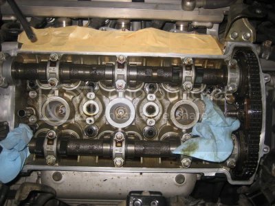

I'm not sure how long it had been running like that...but it appears it had been awhile:
TheNewYear129
This is a steady diet of GTX:
TheNewYear130

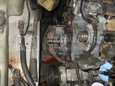

Well, got her back together last night and she fired right up on the first crank. Smooth and quiet.
I must say that the guys (Kurt & Mike) at www.shosource.com - were absolutely awesome. They got me a 'rebuilt' timing belt idler bearing, one of their new ATX products. It was great to put a new bearing on, as I found my old one was on its last legs. A nice quality piece.
It was also nice to have a new Ford thermostat in there and ECT. Instead of taking 5 miles to warm up, she only takes about one (original cats w/ 230k, and i'd like to keep it that way).
So, what started out with a thermostat and valve cover gasket replacement turned into:
Thermostat, valve cover gaskets, ECT, front main, CPS, timing belt, water pump, timing belt idler bearing, and timing chain tensioner.
She runs like a champ and ready for another 60k (hopefully) before she has to be opened back up!
