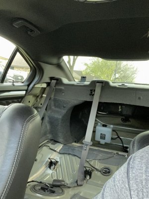

8533f4d3c2d579fc116f8094dab546e8
That’s why I take the back seat out, gotta keep on eye on the tank ;)

Well..... I'm sure that's not the ONLY REASON why you remove the entire back seat.
Winky wink
Ok ok ok, you got me. Stay tuned - I have a major new upgrade to the SHO I’m announce soon. Think weight reduction, luxury, and functionality. Should have results from the track this Friday with all the evidence to back up my claim.

Could this modification be similar to the carpeted and sound deadoned aluminum back seat delete I made and currently have for sale in my 2015 SHO?

skyshadow07
Nov 15, 2019
959
925
Oklahoma
If you're long term deleting your seats, you might as well gut the rear doors too. No need for a interior panel or window motors, controls, etc etc. Could save some real weight.
