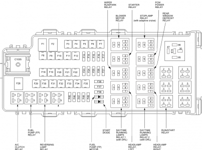

Try swapping the starter relay with the wiper relay. Try swapping the run/start relay with the reversing lamp relay.
Verify the numbers on the relays are the same, they should be.
Also, possibly an intermittent Transmission Range sensor.
Also, possibly an intermittent Transmission Range sensor. Check the connector and switch for corrosion.
Thanks, this was just what I was looking for. I see the start relay. What is the start/stop relay for?
Where is the transmission range sensor located?

Not sure exactly what the start/stop relay does.
Unfortunately, the range sensor is inside transmission where the shift linkage is. Older transmissions had the range sensor on top.
The proper way to diagnose is to use a scan tool to monitor the PID for the range sensor. In other words, the PID should match the actual position of the shifter.

I went to Ford and bought the start relay and start/stop relay. Took it out for 10 Mile drive and it restarted when I got home. Waited 10 minutes and it restarted, waited another 10 minutes and it restarted. Now I need to prove it. This means driving it as normal and carry my AAA card.
