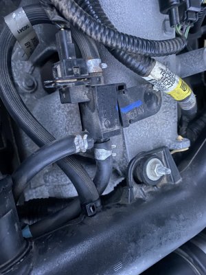

Check the Zip tied hose in the pic. Had a similar issue and that hose was disconnected.

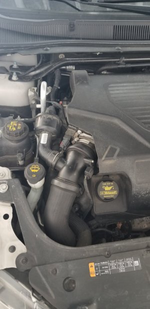

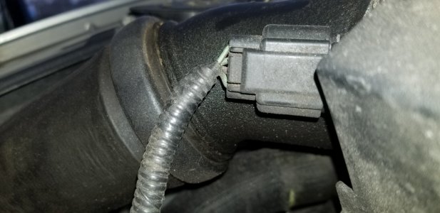

Next check after the simple hoses is look over your noisemaker pipe. Mine recently failed, you can see the oil residue on mine. Also had intermittent power issues. New pipe felt like I just tuned the car haha20220107 12564320220107 125710
