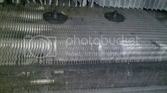

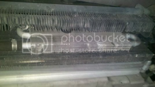

While under the car at work we discovered a tranny cooler between the radiater and the regular tranny cooler. I didn't know it was there but I've never really inspected that area and I've never had the underpinning off. Here are two pics I took.
2011 06 24 18 52 39 395
2011 06 24 18 52 45 903
Is this an aftermarket cooler or are we mistaken by something else?

Gen3's come with a factory tranny cooler that is really small (tube style) but that is an aftermarket tranny cooler.

That's what we thought it was. The factory cooler is still there you can see part of it in the second pic...its stupidly small. Would it still be benificial to swap the gen3 cooler for the gen2 or is this a sufficent setup?

^ Delete that one. That is a cheaper aftermaket cooler. If you really want to keep an eye on your tranny temps install a gauge with a quality aftermarket cooler and a fan on the cooler on a switch in the car.
If you want to keep it simpler just use a GEN 2 tranny cooler instead of the one (or 2) you have currently. They do a fair job.

Just the gen2 cooler wont be enough for the job; If I were you I would remove the aftermarket cooler you have and put a gen2 cooler in series with the factory cooler; thats how I have it and been running like that for the past 110k miles and my tranny still running like a top. (Factory tranny with almost 208k)

Gen2 cooler is way better than those little stack coolers (I can tell by experience) and since you will be installing it in the front of the bumper right at the lower grille its gets way more air flow to cool it than the one sandwich in the radiator.

Bypass the Gen 3 cooler all together, remove the crappy one that was previously installed, and get a Gen 2 cooler. That's all you need unless you are "to the floor" at every light. The Gen 2 one has better surface area to help keep things cooler and if you want to go all out, upsize the lines for better flow. IIRC, the same size cooler is used for the power steering as well as the tranny. All of my Gen 3s sufficed just fine with the Gen 2 cooler and I had one of the best AX4Ns out there backing my supercharged Gen 3.

Actually there is no need to bypass the OEM cooler. It is more than just a hollow pipe. The tube and fin cooler as shown in this thread is not anywhere near as effective as the tank end types.
