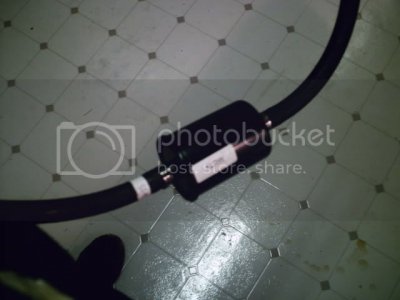

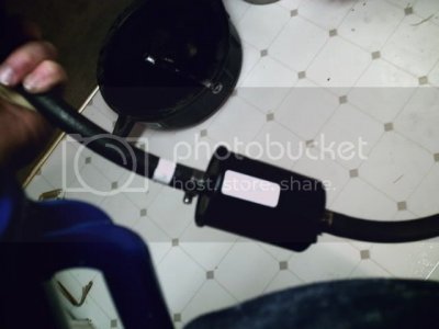

I put an inline filter on the power steering line, it looks like a fuel filter. It was from autozone and actually listed as a powersteering filter. Autozone Part # 2210:shrug: just a suggestion.

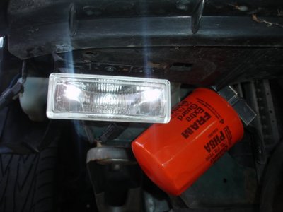

On my GSX I installed an external filter. Works on a FL1A ( I think ) Large Ford filter. Summit racing had them for about $30.00
Much better choice IMHO.

I posted over on the TCCA about using a spin-on external filter. one guy tried it, said that it worked OK. I have an old remote oil filter head I am going to use for mine.
good thing about using a fram PH8 is that it has a bypass valve, so even if it plugs it will flow.
