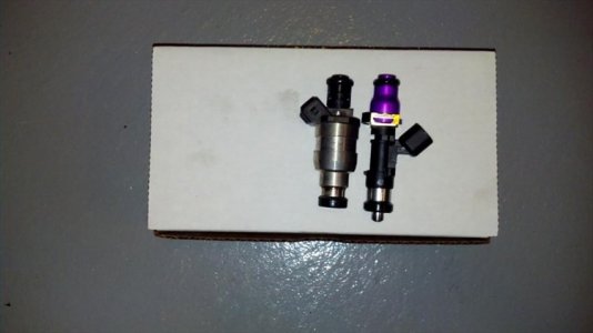

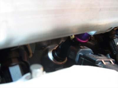

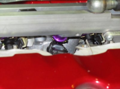

Got some time to swap the ID1000's into the SHO, as well as a WRX. So far, everything seems swell. I tried to pressure test it, but apparently I need new crush washers on my banjo bolt from one of the 2 feed lines. I was able to get it up to pressure with the leak and didn't have any leaking from the injectors.
Some notes:
- From seal to seal, they are perfect.
- You don't have to worry about the seal going too far into the rail as the bevel of the aluminum (purple) adapter does not allow it.
- The Aluminum adapter also helps apply pressure to seal the seal in the head.
- I elected to use the "Denso" cushions in the head and they were a perfect fit. I tested the stock seal and it appeard that it would work as well, but I figured I would replace.
- I did have to cut off the black plastic ring on the bottom of the injector. It is there for to hold O-ring seals and actually should have been removed prior to me receiving them as I elected to get the Denso cushions.
- I have not installed the intake yet, but it looks like the Ford Racing EV1-to-EV6 adapter will fit without hitting the intake... It's a tight fit.
Comparison: Accel 48 lb/hr on the left / Injector Dynamics 95 lb/hr on right

Fitment
15902192 large
15902190 large
