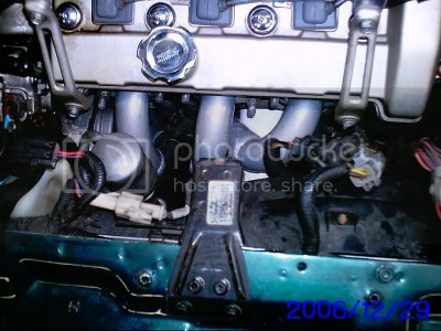

DAMN! That powdercoat header look sharp... IIRC you said in other post about obtaining the hi temp powdercoating system from Eastwood?? what model was it?? hotcoat or procoat? was it simple to use?

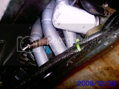

Those are sweet as **** looking!! I want a set! :rofl: Be cautious of that coating though. I used a high temp powdercoating for my shorty headers on my F-150 and they still flaked and rusted up after a while. Great job on them bro. You got skills to pay the bills!:woo-hoo:

Yes, just to give a reference : my Autometer EGT can show as high as 1400 F on a long grade up hill without boost. I believe the Eastwood stuff is only good to 1300 F.
On ebay , type "hotcoat hi temp" in the search bar. It should come up with 6 results. This is done with th 80$ eastwood hotcoat gun.

All you need after that is a big enough oven , note that you cant use the one you use at home for food. I grabbed one for free and slammed it in the garage. All I had to do is make a connection for it in the electric panel (220V oven connector).

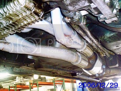

Hey Doug, I have a set of these I will be installing soon. What is the red sealant you used on the slip joints? Thanks alot, Kevin.
These headers sell for $1200 for the headers themselves. In the pictures I posted, we made a custom flexible coupling and converter (GA emissions) that connected to the cat-back system. Turned out pretty sweet.
When assembling them, we use a super high temps silicone, but your basic Chevy Orange High Temp silicone should do the trick.
