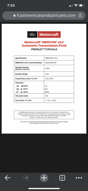

Highly possible it's perfectly compatible with the 6F55 transmission.Screenshot 20211103 215926 ChromeScreenshot 20211103 215648 ChromeScreenshot 20211103 215616 Chrome

It states above that it isn't backwards compatible, but if you look at the Amsoil that is listed for our transmission, the ULV compatible fluid shows as something that can be used in our transmission. (at about twice the cost - still cheaper than a new transmission I guess)

To be completely honest I’ve seen wayyyy more 10R80 failures than any other Ford transmission in the last 8 years. The 6f35’s are the runner up for sure though. Have only had to repair a few 6f50/6f55 transmission. One being my one, but that was a driving habit induced failure haha. They really keep the secret sauce to themselves with ulv, I couldn’t find much about the additives except that they basically allow the clutch and steel plates to have less friction between them when the clutch isn’t applied. Mostly to keep heat and wear down. The flash point of the ulv is also 370f vs luv 421f. The main advantage of the ulv is extremely quick hydraulic action. I’m sure we are all going to see some type of failure related to this fluid, if more try it. Probably just some burnt clutches that wouldn’t have burnt out quite as quick due to the fluid different additives. But it will be neat to see. Most 10r80’s I have repaired have relatively low miles, have seen some with worn valve bodies and also burnt out clutches with no seals failing in the transmissions at all. Mainly 3 clutches they share a “cylinder” in the transmission. As I said before I may be willing to try this out and beat on the 6f55 a bit, simply because if I have a failure it won’t be a huge expense to pull it and see what happened and repair it.
