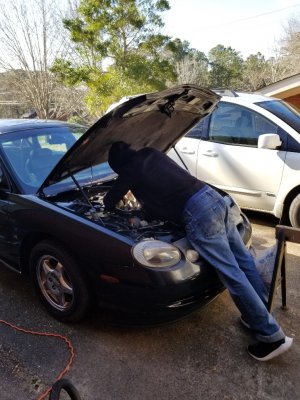

I got the plugs and coils changed over the weekend, so excited!!! My son and I changed the fronts when I got home from work Friday afternoon, showed him how to do it, and of course it was super easy. Saturday we changed the rears. I explained to my son that it really isn't all that difficult, it's just time consuming and you need to keep up with all the things you are taking apart. It took us about 3 hours to change the rears, we probably could've done the job quicker but we cleaned the intake and surge tank and re- wrapped the wiring harnesses and that took a little time. All in all the job went well, didn't break anything and I only came away with 2 small cuts on my fingers, lol. I've had the intake off before so, it was kind of fun remembering what to remove from the car body and engine, and I found old instructions on V8SHO.com that I had used many years ago as a refresher. We finished up the job just a little before sunset and then went for a drive. Man oh man, this baby is running so good!!! I just cruised around the neighborhood a bit letting the engine warm up and immediately noticed just how much better the engine was running. After it warmed up, we then got out on highway 280 and got up to speed with absolutely no misfires, only a smooth surge of power!!! Oh the sound was so sweet!!! Out on the open highway, I gave it the beans and she just took off sounding and feeling like it was effortless!!! It was really fantastic watching the tach needle climb and drop with each shift, no fluttering, just smooth as silk!!! What a difference new coils and plugs make, it's like a new lease on life for this car and I hope to keep her on the road for many years to come!!! My baby is back!!! Yay!!!
Thanks to all for the support in the "return from death of my SHO". She sat for 8+ years and today she is a reliable machine again!!!
Here are a few pics. 56f68ec5d12ebd39574de43127d66e0f0781931a1990ce0b0bf91f84fe92c59c6c14362fa1656dd10c754ad2fddbacc939e4cbaa1bef94ab5c8f5a1454dfec2e3b7e6a37c9943f78a81e58d55a1486d6Eceea9637af7e0a120ba3d80b2eccf1052fe7088021f3141124ee1a0dd6ba0fdC0cfadd614d32db5386d5152edcd34f58c341bd4bde40017377440553c9fa811B9f57838ba88c6d9a964673e68903cbe
