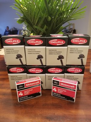

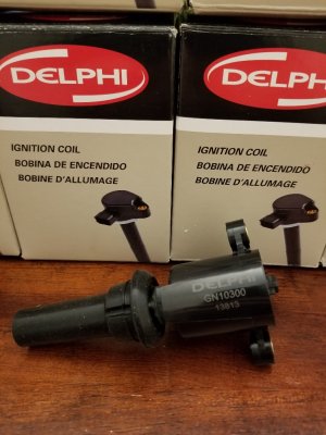

Thanks for the links. That price for the Delphi coils is the best I have seen for those, they are usually way more than that. I just read earlier that today, Delphi has been acquired by Borg Warner for 3.3 billion dollars. Wow!!!
