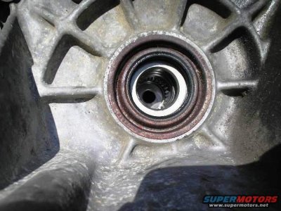

Ok will pull an axle sometime soon. And does it matter which axle and what should I look for when I pull the axle?
firebat45
May 7, 2008
869
472
Edmonton
Either axle, look for a rod going across the hole. (Your diff pin)
Rod = Stock
No rod = Quaife
