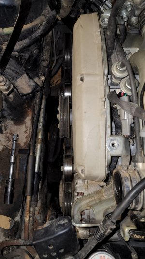

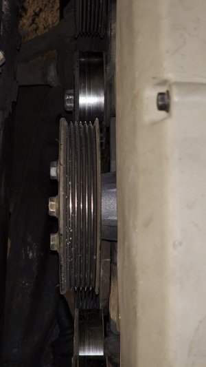

So I installed the new water pump, timing belt, cam sensor, and main and cam seals last night. And ran into this20220721 030145
20220721 030139
The pump is slightly longer in the neck and now the pulley doesn't line up. I didn't want to install the belt because that seemed like it would be bad.
Is it going to be that i need a new pump, or can I get a new pulley, or spacer of some kind?

what brand and part number pump did you get
did you compare the length of the new pump with the length of the old pump you replaced

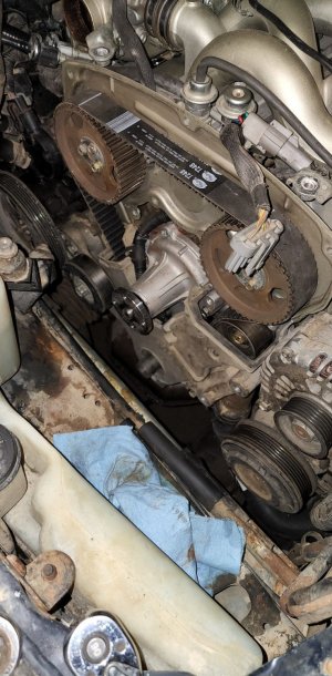

The length seems to be quite close. I think it's just where the pulley mounts to it
60feb4e2 7683 47ff aafe 5de0c7877edcMSGR PHOTO FOR UPLOAD
Fb6771a5 7c83 4a2e a93d 58d036672504MSGR PHOTO FOR UPLOAD
I don't know how hard it is to tell, but the thickness is a little fatter on the new one

Looks like that part number is for a MTX 3.0 engine, it is different part number for a ATX 3.2 engine. Look at the rockauto page
BluTyger
May 22, 2022
86
16
Colorado
Darn it. When I saw it didn't fit, I suspected as such. Just raised my hackles, or whatever. Welp, looks like I'm taking it all apart again

Looking at the old to new I am noticing that the old has a nose on the piece where the pulley mounts which is flush with the pump shaft. The new one has no nose or the pulley mount may have been intstalled backwards putting the nose on the other side witch is making the new pulley mount stick out more forward.

Yeah, I actually initially installed the pulley backwards, noticed it, swapped it, and it still didn't fit. I also noticed that the old pulley had the ****** or whatever that helped keep it aligned. But where the pulley mounts is way thicker
