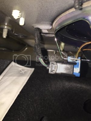

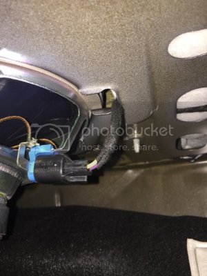

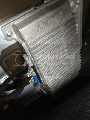

2013 SHO with sony system I need some help figuring out which cables i hook into the back right before the stock amp. i want to run it off just the rear speakers. pictures would be nice. thanks guys
danny mage
Jan 15, 2015
27
Can someone please help me i have the Line out converter and just need to figure out which wires to tap into. also if i need to tap into the sub wires or the rear speaker wires PLEASE help

Not sure on color code, I would advise to use the subwoofer output lines. I know the regular speakers are regulated so they don't blow, so you will lose lots of bass. Experienced this in my 12 Focus with the sony system. Once I used the sub out lines, was perfect.

well looks like your in luck, they are the same as the schematic I have from my 12 Focus lol. Here's the pin out. Sub1 + is Violet, Sub1 - is yellow. Sub2 + is Green and Violet and sub2 - Gray. They are both going to one speaker correct? its a dual voice coil speaker.

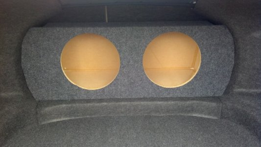

Ah ok makes sense according to the schematic. I really like the box above. Looks like a good fit. I plan on maybe just doing 2 10's. I really didn't want 2 tho :/ .
