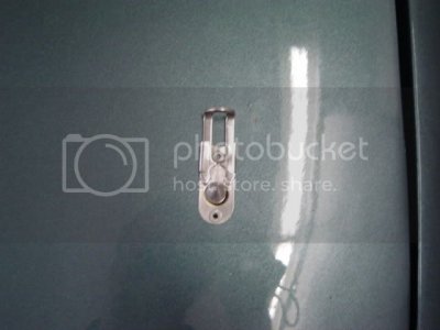

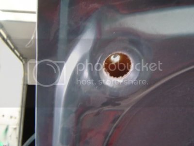

Mikescarblue023
Mikescarblue020
then i removed the bump stops and used the holes that were there for the studs and as for the bump stops i used a black rubber hose for adjusting the height of the hood. it fits great and does not move when going down the road. and i dont have a latch i moved it down so far the hood only reaches the safety catch so if some ****** undoes my hood pins the safety catch is still there so il notice it and pull over i suggest this for anyone else too cause the fiberglass hood just didnt latch like it should so i did this
