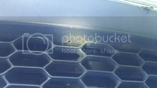

I purchased my SHO with holes in the front bumper. I needed to get a car fast and decided I would live with it. I just couldn't stop looking at it. I came up with this idea to help ease my disorder.

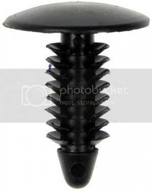

Purchased an assortment pack of plastic barbed trim retainers from auto parts store also available individualy at Ace hardware.

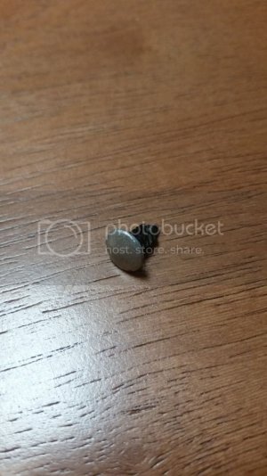

I picked two of the size I liked and sanded the surface and edge with 400 grit sandpaper.
Washed with soap and water and dryed.
Painted with touch up paint and clear coat.
20160629 210010 zpsai5ecs8m

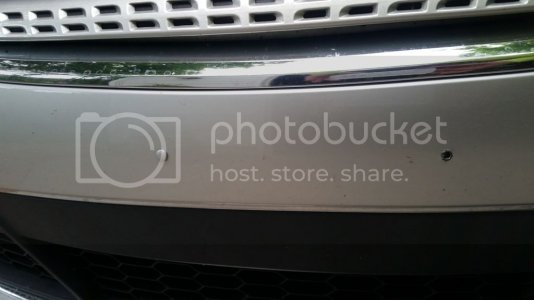

Here is one installed, one not.
20160629 195616 zpsf8wmehc8
It's not perfect like a new bumper but I feel a lot better looking at it every day.
