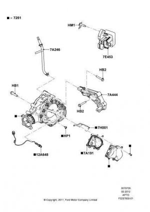

7A246 is the vent tube. It goes into the top of he ptu.

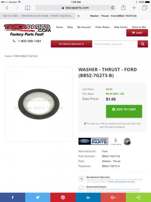

The clicking might be related to the pop ting tsb that is associated with the cv shaft bushing.
I have that tsb # somewhere.

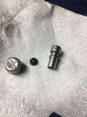

For reference here’s the jiggle valve removed and disassembled.
Ab10959b2a7eb31289e9ff542dae2d54
This is the part that gets clogged

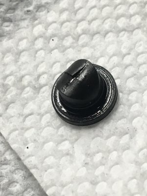

Here’s the updated part from the pop ting tsb. The old one is all metal.

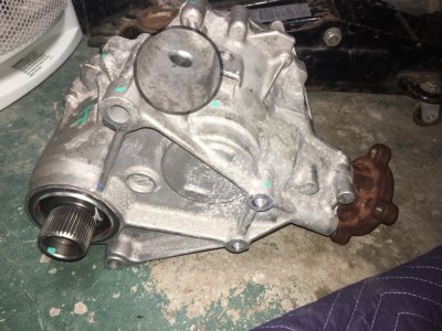

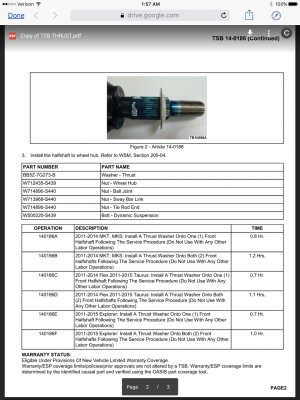

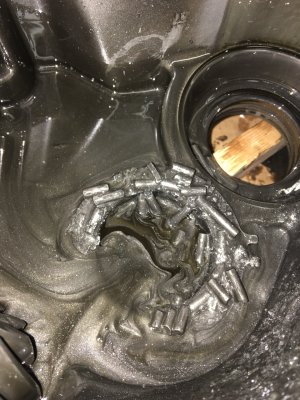

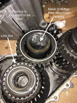

Worst case scenario is what happen to me. Thurst washer failure under load
= grinding

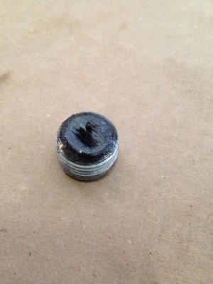

For Reference here is my plug after approximately 24k miles. As far as I know it was the first ptu fluid change.
1a260a13241984fad391efaef03e4283
It looks pretty similar.
