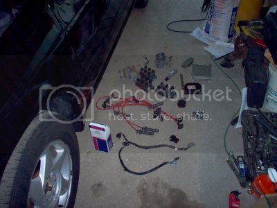

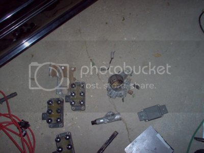

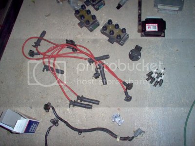

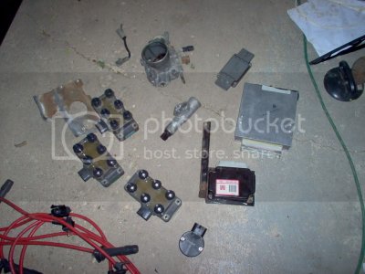

all parts replaced (add on fuel rail harness and main wiring harness - they might get replaced yet again)

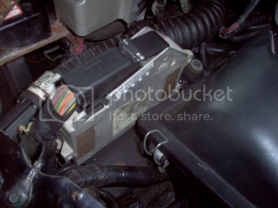

then i have a few questions:
anyone know what this is?
IM000067

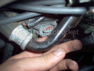

anyone know what this connector does?
IM000068

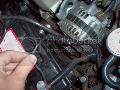

is there fuses or anything like that that could affect my starting in here?
IM000075
could the starter solenoid affect spark at all?

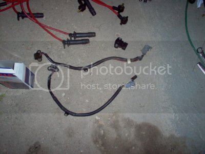

what is this connector used for and why can't i find its other end?
IM000074
(it comes off of the fuel rail harness near the 5 connectors - it's a rectangular connecotr with 3 wires coming out of it)
it was on the fuel rail harness off a '91 in the junkyard, but it wasn't on the one from my car...?

The plug you cannot find is for what looks like the dpfe sensor, for the egr valve. The sensor on the firewall is the baro sensor, it will not effect spark. You have the ground wire on the intake to the firewall?

i have the ground connected
my question becomes : the car didn't have an EGR at the junkyard and neither did my car, so why would there be a connector for it if it wasn't there?
All of the harnesses have the plugs.

Yes! in pic 7 ,-the one I quoted I hope-Is a single connector under all that tape & if not connected or is bad car will not start cause it is power for the fuel pump! I thought it was a fuse holder but just checked. Does your fuel pump prime?
