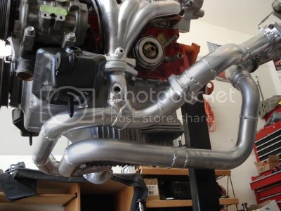

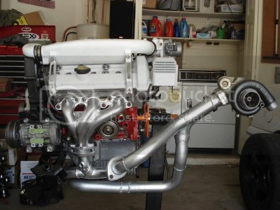

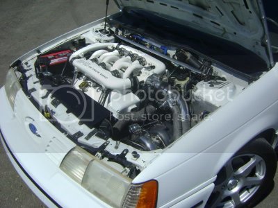

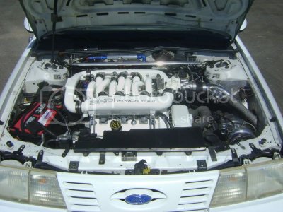

Before anyone suggests a single larger turbo, there is no room for exhaust routing for that
While I'd love to see a clean twin setup on a SHO, I think you will soon find that to be just as much of a headache as a single...
This setup makes plenty of boost before I'm even ready for it(~3k) and pulls all the way to around 7k.

Hes not putting it in a SHO.
