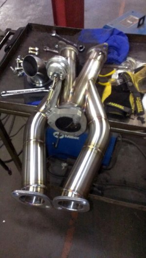

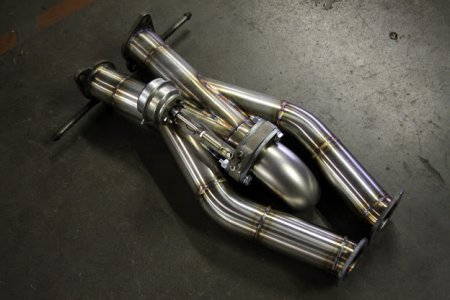

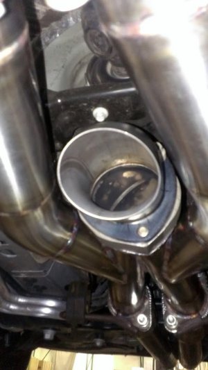

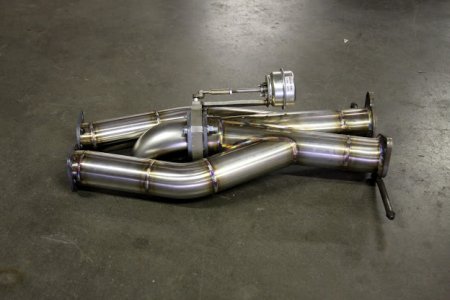

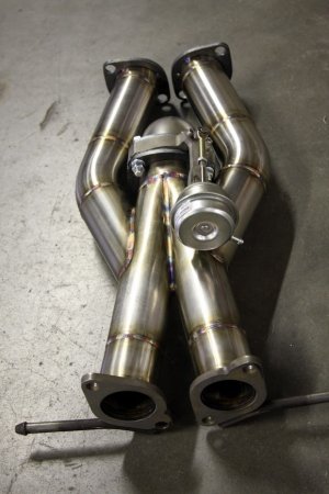

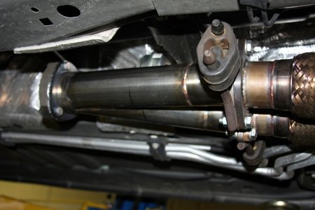

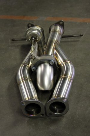

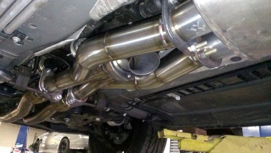

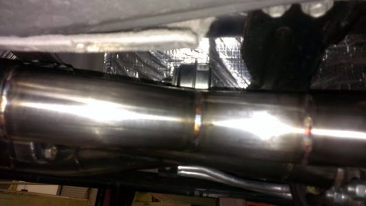

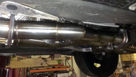

This is a Sound and Performance boost activated cutout seen here:
http://www.spracingonline.com/store/SP_Exhaust_Cutout_3%5C___Boost_Activated_/3673
When over 6psi the cutout opens up - here's my video on it working on my stock downpipes with a bad H pipe install and on 91 octane tune at around 12psi. I haven't had a chance to test it yet with the new 23 psi tune. Previously this cutout picked up .2 and 2 MPH for me in the 1/4 mile in back to back testing. I like this versus a loud exhaust so I can have a quiet exhaust 99% of the time and loud when I want it.

Beautiful work. If I could make something look half as good as that, I'd be happy.

I just called Sheriff "JOE" and he said that your cutout is illegal and he is on his way to your house to arrest you!!! LOL!!!! How will you look in pink????
I have looked at pix several times and it really is a work of art! When you move on to bigger and better things... I will look good on the wall of your "Man Cave"......
