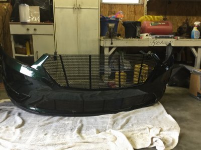

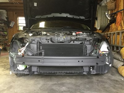

Bumper cover removal is pretty straight forward. If you're changing grills, be sure to black out the actual bumper and any painted surface (as pictured above). Be fairly careful unlocking the tabs on the bumper cover where it wraps around the side to avoid damaging the tabs that hold it in place or it won't lock back in securely. One thing I've found with the GTG grill is that the powder coat is subject to rock chips so keep some gloss black touch up paint on hand, probably the same on any painted metal grill.
