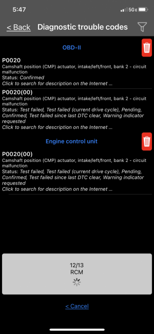

So ive been getting this error intermittently and now more often. Clearing the code seems to last maybe a day and then it will be back.
Lots of research makes it sound like its maybe just the cable / wire-loom to the VVT sensor/ solenoid? Car runs like a rocket no rough running or stalling. 2015 88k miles.
Would replacing these connectors being something that is doable for a partial idiot?
Are the parts on rockauto and not a ton of money or should i go to a pro?
Thanks as always. IMG 8131

Thats encouraging at least. Now i just gotta see if this is something that i can do

appears i just come here for emotional reassurance lol. connector was ******. firmed up the connection, drove like a nut for 20 mins, no code.
should be easy to replace.
