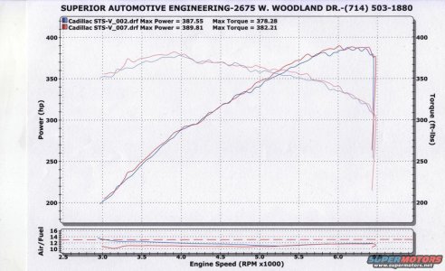

I found that the dynapack reads about 14% higher than a dynojet for me.
Stsv final  1024
Stsv dynosheet 2  copy
I had the car tuned on the dynapack and retested on the dynojet. Since we have 91 Octane gas my tune is very conservative.
I had other friends run their CTS-V and Buick GNX with the same difference in readings.

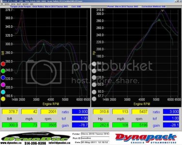

Hey guys,
I am in a bit of a hurry, but wanted to inform you about the results :
stock : 282whp and 300lbs tq
Livernois stage 3 : 301whp and 310lbs of tq
Livernois stage 4 : 311whp and 305lbs of tq
With the tunes, there was a big consistent spike (378 for stg 4 and 340 for stg 3) in the torque at around 2000rpm which was not there in the stock tune. Also the torque was holding longer over 300 lbs with the tunes (between 3000 and 5,500) as opposed to stock...
Air/fuel ratio was around 12 when tuned and 14.6 not tuned.
Runs were made in 4th gear.
So, if stock is 280whp on the dynapack, stage 3 made about 7% more hp than stock and stage 4 10% more. The guy was telling me that it made sense, since usually 1 psi gives more or less 10hp and with more timing... about 29whp more or 40hp at crank more with stage 4...
I was expecting a bit more, but it is not just the power that matters, but how it is distributed and this is where Livernois did an amazing job.
So, for just a tune, I am happy with it... I would be curious to see the stock numbers when Anike7 did his dyno testing giving 327hp/330lbs on stage 2 with just a CAI...
Comments welcome and video and picture to come soon.

It's Dynodoc in Montreal 6565 Durocher (close to Beaubien and Du Parc). It is worth it to go for AWD, but he can also do 2WD. The setup is long though as he needs to lift and remove wheels put dyno on each ... for my car it was about an hour of setup.... Then the car was refusing to shift into third... with an ABS error message... we removed it with device and then good to go. We did 1 run stage 3, 2 stage 4 and 1 stock (that was not long, just the time to flash between runs, so all-in about 30 minutes for the 4 runs and then another 20 minutes to put back the wheels. So I was there for 2 hours and 45 minutes (because of issue with error message). The guy is named Brady and seems to know what he is doing, looks passionate about it and very nice guy.

The stock program a/f was 14.7 under WOT?? That's not right...should be right around 10.7 from the factory

that does seem a little low... hmm
It thought so as well... People have be mentioning a drive train loss of 25-28%... IF the 365 announced by Ford is accurate, the reading of 282whp would correspond to a loss of 22.5%. The stage 4 would then be 401hp at crank. Apparently Airaid CAI is not supposed to add hp, but again I wonder how Anike5 stage 2 with CAI arrived to 327/330... If someone knows how much Anike5 ran stock on the same dyno, that would give us a pretty good idea of the increase of the tune. But again, I really feel a huge difference between stock and stage 3. Leaving the place today, I had put it back to stock, ran a few blocks and it felt slow! Especially the kick downs that were taking more time to respond and less feeling of being absorb by the seats... After 2 minutes, I needed to re-flash the car to stage 3... Once you tried it it is hard to go back, beware everyone!

The peak gains we see are never huge going from stock to any of the tunes, but the areas under the curve and after the curve have gains of as much as 90 WHP in areas.
