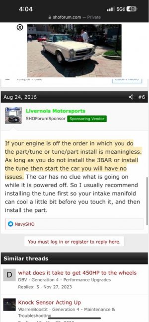

Adding tune now I’m going to keep it off so it doesn’t know anything then add parts.3b39fb6b968c67630fd1e422a2c58ebc

Adding tune now I’m going to keep it off so it doesn’t know anything then add parts.View attachment 89731
I don't agree with that. You don't install it with the engine running, but the switch must be on to download / upload. I don't think the temp of the engine has any effect on flashing.
I've never dealt with Livernoise, but they don't have the best reputation in the SHO community.
Sent from my SM-S928U1 using Tapatalk
I am a believer that livernois is why I lost cylinder one on my motor. Others with the same tune have had similar problems, unfortunately.
That said, I had no problem loading their tune and in fact I did it on my way home at a gas station from when I bought the car lol.
Car in ON mode (not accessory) but engine not running. In other words anytime you're hitting the start button your foot should not be on the brake. This goes for any tune to the best of my knowledge unless you're playing with a diesel.
