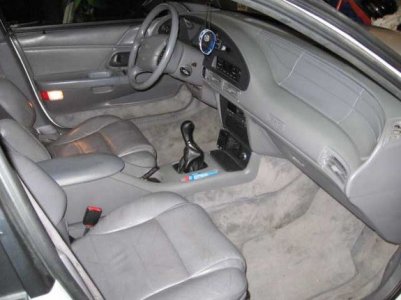

Well, I know for a fact that the clocks were different between 92 and 93-95 and they weren't interchangeable, which means the dash bezels aren't the same. And according to these pictures:
1992:
29552020017 large
1993:
9405010043 large
The angles aren't quite right, but you can see that the steering wheels are different on the 92 and 93, which means the air bags are different. that's my point. 93-95 are identical as far as the interior goes.
And, FWIW, I have a 95 ATX and used to own a 94 ATX. I never once found any wiring differences in the interior. My '94 EVTM worked perfectly for the 95.
Forgot about that one.
They are not. Somewhere between 93 and 95 there was some change in the B-pillar area. Don't remember exactly what, but I remember having an issue when I did a black interior swap into a 95 from a 93.
Also, the console sides of 95 seat bottoms were cloth instead of vinyl.
