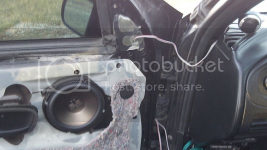

If the negative on the woofer and tweeter are on the same circuit there is an easy alternative. You can reuse the existing speaker wires and there is an extra wire in the door harness that is not used on the Taurus. It's a two wire connector for the window button illumination that used on the Sable. One of the wires is connected to the ground circuit in the door harness and the other goes back through the big connector and back to the illumination circuit.
Eric VerValin
PiMPSKiLLET
Mar 28, 2005
3,187
649
Fort Wayne, Indiana

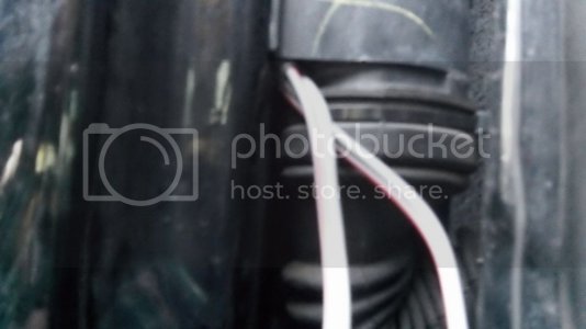

Nice idea there! I just read about that little light, and didn't even think about that... :) What I did notice however is how much room there is right infront of that thing. One little hole in that boot, and this wasn't a problem at all... lol Check it out...
100 0073
100 0074
100 0075
I can see the end... :)

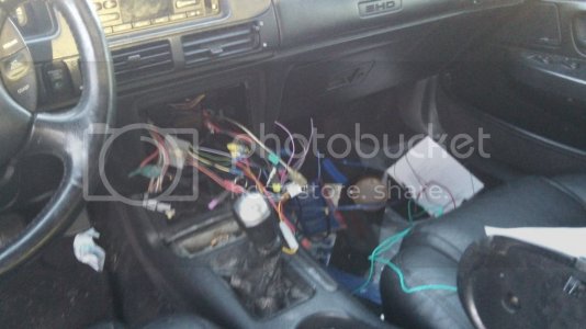

Well, it all works fine, I'll have to get a video of it up here tommorow. I turned it on, it found my home network, my phone, my phone book, addresses, contact lists, pulled the music including ringtones. This is a lot more "Radio" than I'm used to. lol It even scolds you when your speeding.. lol
Still waiting on my 4004 amp to show up so I can finish building my false floor in the trunk and all that. But if anyone wonders... those DB's are nice w/o an amp. :) Very "bright" sounding. Now I gotta figure out what I need to setup my crossovers and all that jazz at. Haven't even bothered to look into that yet. I just know where my sub cuts off, and thats where I set my LP filter on my amp for the sub.. :)
Would setting those up in the HU help out a lot as far as SQ? I'll have to get a video of what options I have. I can set FQ's for bass, mid, and high's. Plus two different bass boosts.. but WTH? I have one of those via the gain on the amp, and the **** that comes with the RF amps. lol Too many choices...
