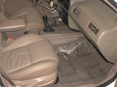

ohioshodude
SHO'ld fogy
Jan 14, 2001
2,701
107
delaware, ohio
only pic i could find. i also have a few pics from the front looking in, and the back seat. i'll keep looking.

I want to do that in my 93 with mocha interior. Will those color seats match the interior of mine?
30footSHO
In da mountains
Oct 7, 2002
593
14
Boise, ID
The 3rd gen mocha is a little lighter than the 1st and 2nd gens, if only because it is newer. The leather is different as well. Someone out there has to have some more pics.
